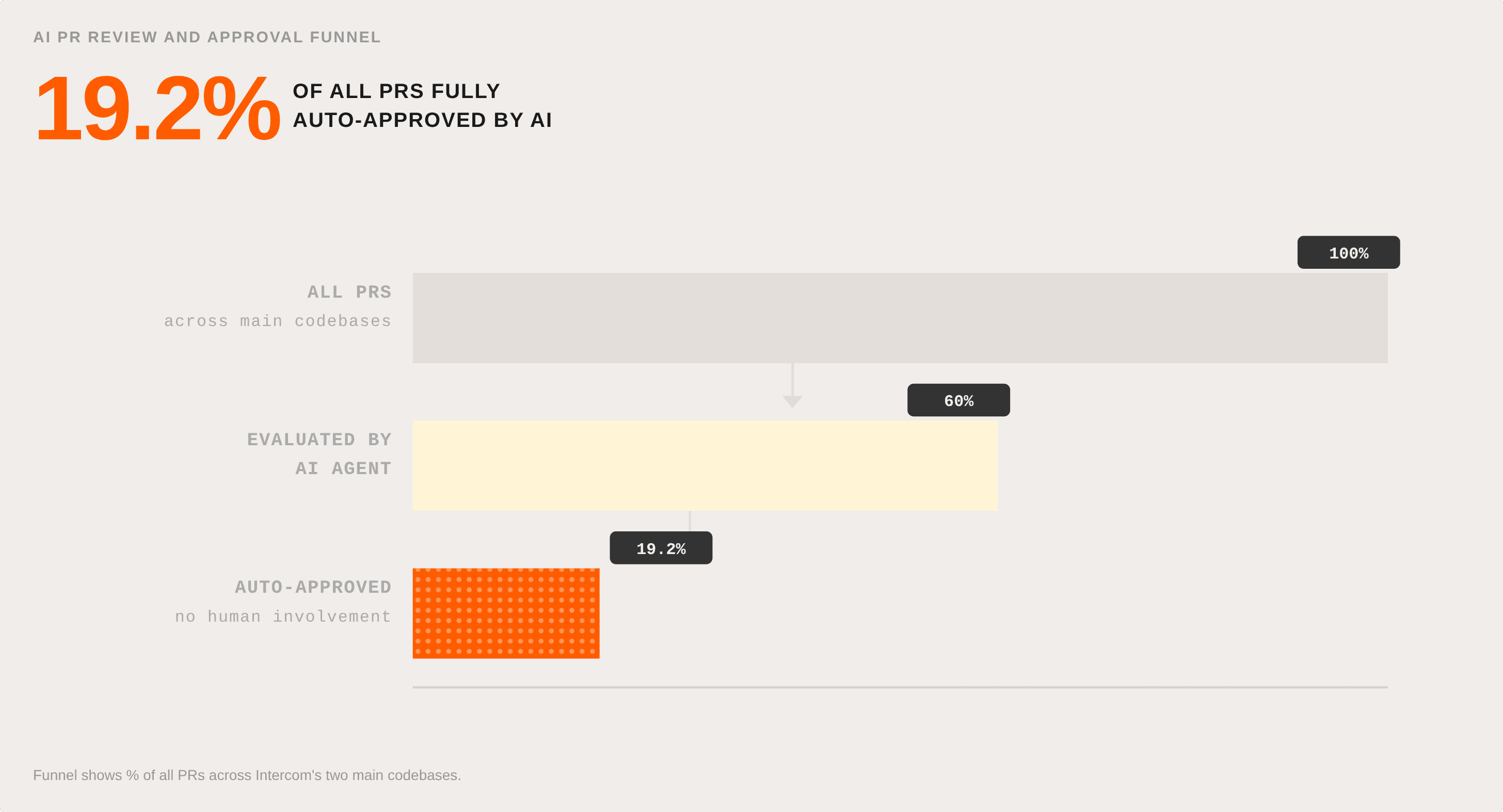

Today, over 93% of our pull requests (PRs) across our two main codebases are Agent-driven. And over 19% are auto-approved with no human reviewer in the loop.

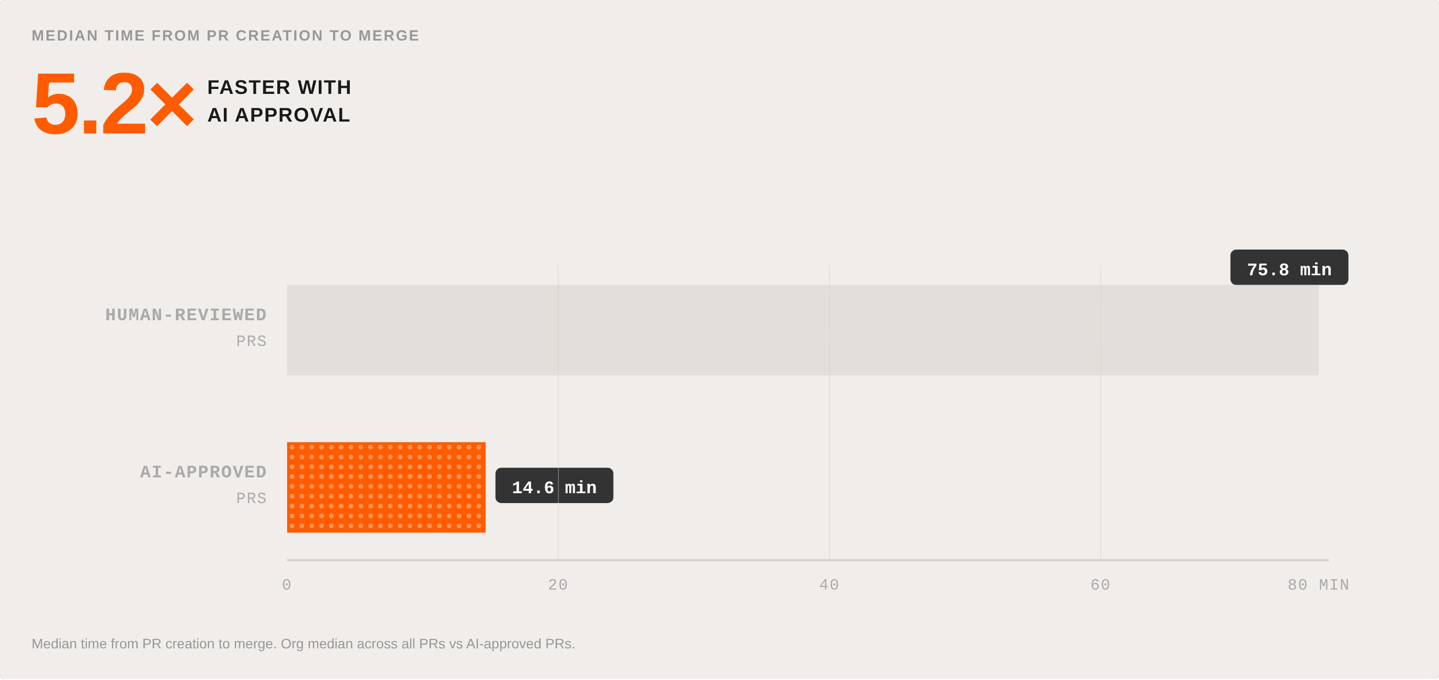

We started with a controlled pilot of over 100 PRs through the AI approval pipeline. The results: zero reverts of AI-approved PRs, and a 6–16x improvement in time-to-approval at the 75th percentile. Since then, the system has scaled significantly. In the first four weeks of broader rollout, 497 PRs went fully autonomous, with Claude writing the code and our AI approval system reviewing, approving, and shipping to production.

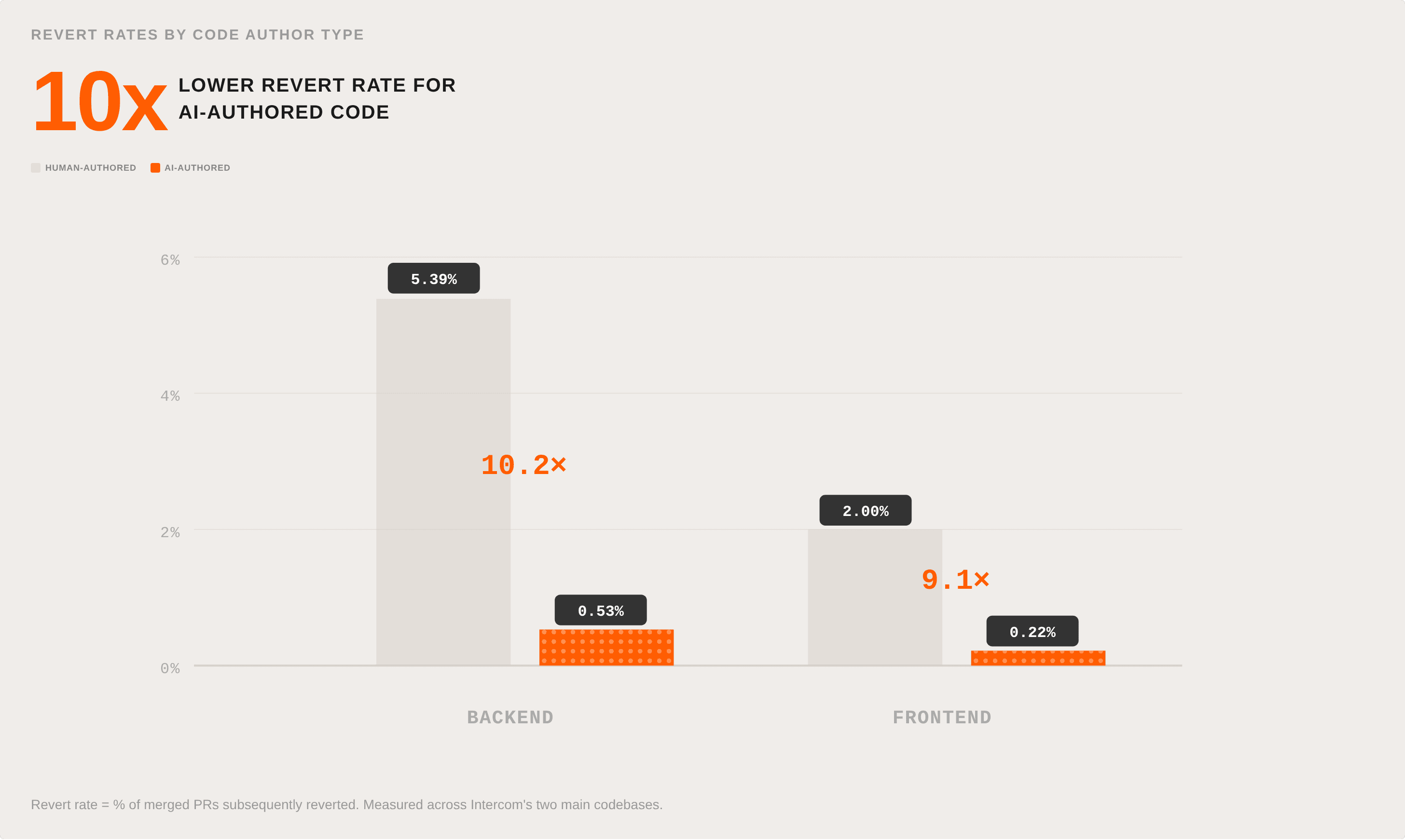

Beyond the approval pipeline itself, we also looked more broadly at how AI-authored code performs in production compared to human-authored code. AI-authored backend code had a revert rate of 0.53%, compared to 5.39% for human-authored. On the frontend, it was 0.22% versus 2.00%.
AI-authored code, reviewed and approved through our automated pipeline, is being reverted at a fraction of the rate of human-authored, human-approved code. We don’t expect that to hold at zero forever, but the data so far tells us that the quality bar our Agent holds is at least as high as the one humans were holding, and in many cases higher.
